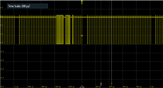

Hi all!
I use the ACM_CDC USB class to transfer a batch of data (150MB) from the MCU (nrf52840) to the host. Currently, the system reaches up to 100KB/s upload speed, although the USB bus is at 12Mbps.
My main, with USBD queue disabled:

And the signal on USB pin 3 while uploading data:
Do you know why there are so many gaps between the data in the oscilloscope screenshot? Could this be a firmware problem? Or an issue/limitation on the host side?
