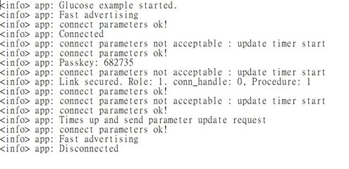

     my log (gls example).
    I added NRF_LOG_INFO in conn_params_negotiation.

  3.Why needs a timer to trigger connect parameters update request ? Could I send first  request  immediately when I get ble connect event ?
  • 1) a) You seem to just have started with Bluetooth. Please go through our Softdevice documentation to understand Nordic's implementation of BLE stack. In short, our stack gives notifications to application through SWI interrupt events and application handle those events it think are relevant to it.
     b) Yes you can, but in the above mentioned code snippet, this device is answering to the connection parameter update request from the peer device.  You need to look at these message sequence chart to understand the flow.
    2 a) You don't need to. But some peers would request different connection parameters based on the existing quality or your device can initiate it for some other reason.
    b) depends on peer and your device, this is not mandatory
    3) We give some time for the peer to finish its service discovery and other procedures to complete before triggering a connection params update. So to wait, we need a timer.
