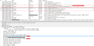

In first screenshot (captured in samsung S4) we see packet #16083 "LE Create Connection" and #16085 "LE Connection Complete". This is the re(connect) to DIRECT ADVERTISE and work perfectly.
We see "Peer Address Type: Random Device Address (0x01)" and "Own Address Type: Public Device address (0x00)".
Before "LE Create Connection" packet exist other packet #16081 "LE Set Advertising Parameters". I don't know the importance of this packet because with (Android 6+) we don't have this packet.

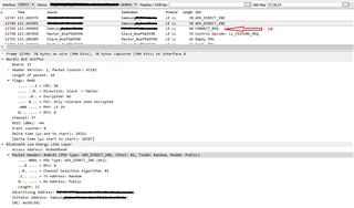

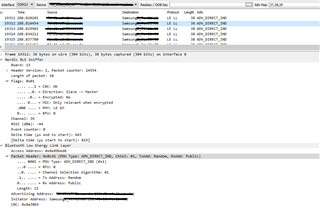

In second screenshot (captured with sniffer nRF51DK) we see packet #12748 "ADV_DIRECT_IND".
In Packet Header we have "Tx Address: Random" and "Rx address: Public" and in packet #12749 "CONNECT REQ".
So, this is the scenario with Samsung S4 where everything works great.

In third screenshot (captured in Samsung S8) we see packet #3021 "LE Create Connection".
"Peer Address Type: Random (Static) Identity Address (Private) (0x03)" and "Own Address Type: Random (Static) Identity Address (Private) (0x03)".
We think the problem is here!!!

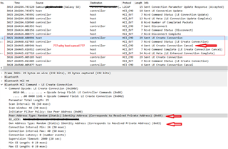

And in packet #3023 the smartphone takes the initiative to cancel the "Create Connection", after 5 seconds.
We don't understand why smartphone cancel the connection.
In nRF Connect App in android have "Error: 133 (0x85): GATT ERROR".
Here we try turn off and on again the bluetooth, several times, but without any success.
In nRF51DK sniffer don't appear any packet from smartphone.
We have in fourth screenshot the DIRECT ADVERTISE packet, and we see in Packet Header "Tx Address: Random" and "Rx Address: Public".
