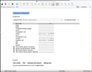

  • Martin,

    So I decided to try to get this up and running on MacOS. No luck there either.
    Here is my set-up:
    System: MacBook Pro (Retina, 15-inch, Mid 2014) running macOS High Sierra Version 10.13.5.
    Sniffer target: pca10040
    Segger J-Link version: SEGGER J-Link Commander V6.16c (Compiled Jun 16 2017 18:19:39)
    Wireshark version: v2.6.1 (binary downloaded from Wireshark website)
    Python version:
    Kens-MBP:~ ken$ python --version
    Python 2.7.15

    Observations and symptoms:
    Target is plugged in and operating as described above in my original post. The interface appears to be /dev/tty.usbmodem1411:
    crw-rw-rw- 1 root wheel 21, 2 Jul 10 12:03 /dev/tty.usbmodem1411
    When wireshark is invoked, no nRF Sniffer shows up in the interface list. Also, there is no Interface Toolbar showing, or even available from the View menu, as described in the User's Manual pdf (note: this was also the case with Wireshark running on Linux).
    See attached screenshot of Wireshark window in macOS context below.
