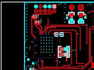

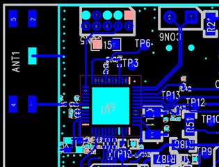

We are trying to run ble_app_uart example on our custom hardware. SDK 15, SD132V6.0 . Problem what we experiencing is: NRD chip never goes to sleep, it reaches sd_power_system_off(); and resets within function. We think it is hardware related issue, because same code (in fact it is an example from SDK without any modifications) runs perfectly on NRF52 development board.
Schematic attached for the reference.
