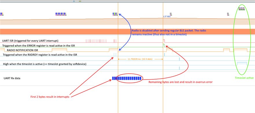

But when the nRF51822 is connected I get UART errors (overrun). I implemented the radio notification for debugging and see that for several milliseconds (4ms-13ms) after the radio is disabled, the UART ISR is not entered even though bytes are received on the RX line. During this time the UART fifo will obviously overrun since bytes are not read from the RXD register. The radio activity mentioned above is normal BLE communication (reception and transmission of regular BLE packets) and the timeslot was not active.
When I change the UART priority to APP_IRQ_PRIORITY_HIGH (=1) the overrun error does not occur, so it seems like the softdevice is blocking the UART interrupt when the overrun error happens(?).

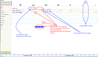

I made a screendump of the scenario:

    In my implementation the use of the timeslot functionality can be activated and deactivated when the device is up and running. When it is deactivated (or when the device boots with timeslot functionality deactivated), the UART errors do not occur. But as soon as the timeslot functionality is activated the UART errors occur when a BLE connection is set up. However I've not seen the UART error when actually being in a timeslot.
    I've been trying to find if any of the event handlers is consuming excessive time but unfortunately this hasn't resulted in a suspect. So far all event handlers I've checked use their normal timing and shouldn't be the reason the UART is not serviced anymore. The moment the UART interrupts are blocked, always seems to coincides with the radio deactivating (and each time it was after regular BLE traffic, not timeslot traffic).
    The common factor I guess is the radio; issue only occurs when timeslot functionality is active (though not actually being in a timeslot), issue occurs after radio activity. Hence my remark about "what could be the relation to the Radio Timeslot...".

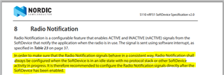

    I read through the radio notification chapter i the Softdevice Specification again, and since I'm under the impression that you turn on and off the timeslot API dynamically at run-time I took notice of this quote:
    Are you handling this?

    Well I checked the events I get from the softdevice via SD_EVT_IRQn/SWI2_IRQn and the sd_evt_get() function. The time it takes to handle those events/received data from the softdevice is not the reason for blocking the UART IRQ. I made a screenshot:
    You can see that when the UART interrupts are missed, the system is not in the SWI2_IRQn ISR to handle the ble events.
