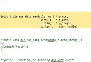

how to pass the parameters in this
see the below pic how to write the data in this
Have you looked at the documentation?
Nordic UART Service overall:
The ble_nus_data_send() function in particular:
