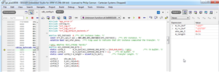

I am using the nRF52840 development kit and running the SPI peripheral example in SDK 15.
I am having trouble displaying a static value in my watch window.
static const uint8_t m_length to the watch window it has the wrong value
If I change the code to
static uint8_t m_length it does not display a value.
uint8_t m_length
it has the correct value.
I think all of these should display the same value in my watch window.
can you tell what I am doing wrong to get it to display incorrectly with the NORDIC supplied example for Segger Embedded Stuido.

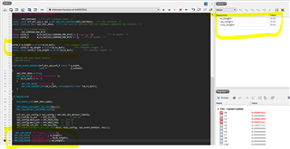

This gives the  correct which is 0x03.
This gives the wrong value for m_length  0x3b
This does not give a value at all.

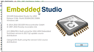

This is the version of Segger I am running.
This is my source file.  I started with SPI as an example and I am working on a FANSTEL BT840 evaluation board.
