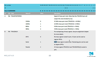

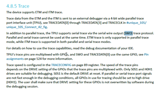

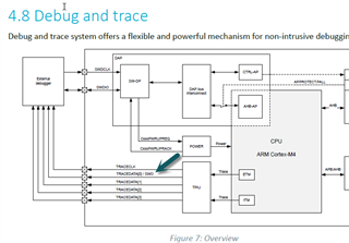

    I am a little confused.  I know that SWDIO and SWDCLK are needed to load code and breakpoints.
    I want to know if the SDO pin is used by Segger RTT
    So my question is can I use P1.00 as a GPIO if I want Segger RTT ?
    or does Segger RTT use P1.00 for SWO (serial wire outptut) which means I cannot use it for a GPIO to control a LED.
  • SWO is not used by RTT - you can use the pin for anything you like. Not much uses SWO at all, even less uses the full trace. There are certain functions in the ITM which will only multiplex over SWO and trace but you are very unlikely ever t o need them. RTT pretty much won here and just uses SWCLK and SWIO
