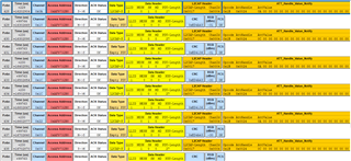

  • and also this is what i can see in the BLE sniffer:
    as you can see, MD bit of packets that nrf51822(peripheral) are sending is always 0 that means that it has not any  more data to send in current connection interval.
    What Softdevice and SDK are you using? I actually just learned that S130 v1.0.0 can only handle 1 packet per connection interval. However, if you use S130 v2.0.0, you can configure the bandwidth with sd_ble_opt_get() and get more.
  • yes, the problem was with setting the bandwidth and my problem is solved now, thanks.
