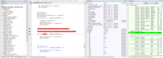

I'm using SAADC example of the SDK.
I read the ADC values and I make an matrix to calculate FFT using the CMSIS library..
the problem is when I print the data after using DSP library (FFT), the program stuck, in dissasembly window appear:
Before to use the Library, NRF_LOG works fine.
HardFault_Handler:
0x15ee: 0xe7fe B.N HardFault_Handler ; 0x15ee
I have the following code:
 for ( int y = 0; y < SAMPLES_IN_BUFFER; y++)
             Incomplex[y*2]=vibdata[y];
             Incomplex[y*2+1]=0;
             NRF_LOG_RAW_INFO("%d,", Incomplex[y]);
             NRF_LOG_FLUSH();
    arm_cfft_q15(&RealFFT_Instance,(q15_t *)Incomplex,0,1);
    arm_cmplx_mag_q15((q15_t *)Incomplex,fftvibout,SAMPLES_IN_BUFFER);
         NRF_LOG_RAW_INFO("%d,", fftvibout[y]);  // ***** HERE the program STUCK in the dissasembler appear HardFault_Handler
         NRF_LOG_FLUSH();
I attached an debugger screen.
Thanks

    Finally, i have spent a lot of time trying to fidn a solution, I got it..
    The error was the position of INICIALITACION OF THE INSTANCE FFT...(arm_cfft_instance_q15   RealFFT_Instance;   )
    Before initialization of the variable, it was located in the Saadc_callback function..
      ret_code_t err_code;
      int cycle=6;
      ******* HERE WAS THE INSTANCE FFT INICIALITATION ****** I moved to #defined zone of the program
        memset(p_event->data.done.p_buffer, 0, sizeof p_event->data.done.p_buffer);
        err_code = nrf_drv_saadc_buffer_convert(p_event->data.done.p_buffer, SAMPLES_IN_BUFFER);
    After, I moved it to at the begining of the program

    Another problem, I realized,  the result of the FFT function all time give me a different result, i saw it in the "Live watch" in the screen shot.
    But it corrected when the instance was moved to the beginning of the program.
