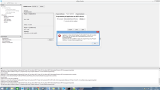

currently i am using  nRF51822-QFAC device with SDK10.0.0 AND soft device S110 now i want to use S130 instead of S110  i updated but my device is rebooting continuously.

i defined S130 in IAR  for both bootloader and Application and compiled without any issue.
Nrf SDK Version : nRF51_SDK_10.0.0
soft device version : nRF51_SDK_10.0.0\components\softdevice\s130\hex\s130_nrf51_1.0.0_softdevice .exe
i am using nRFgo studio to flash above binary
first i flashed soft device mentioned above than i tried to falsh my Application it showing below error
using  tools
IAR EMBEDDED WORKBENCH FOR ARM  7.50.3
J-LINK BASE
nRFGo Studio
please help how to fix this issue
