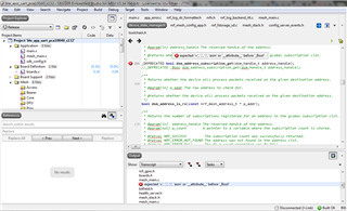

Please help correct the error for mesh example.
Thank You.
SDK : nrf5_SDK_for_Mesh_v2.1.1_src
Thank You.
Could you let me know which example you are testing ?
We don't have that line of code in our device_state_manager.h in SDK v2.1.1
Hi ,
Example path .
\..\..\nrf5_SDK_for_Mesh_v2.1.1_src\examples\sdk_coexist\ble_app_uart_coexist\pca10040\s132\ses
This error is line 255 of code in device_state_manager.h in Mesh SDK v2.1.1 .
Thank You.
Please try again with fresh copy of the file ? I compiled here and had no issue.
You can actually remove that function in the device_state_manager.h and in device_state_manager.c
Hi ,
It is ok .
Thank You.
