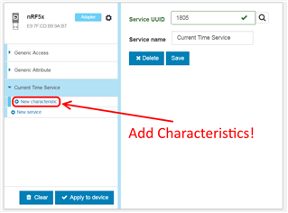

On my nRF Connect app I defined the device nRF52 (also tried CTSClient) and added the service "Current Time Service" (x1805) and then turned on the green switch next to nRF52 device. Then at the Arduino IDE, I loaded the CTSClient sketch. On the nRF Connect app I connected to the  advertised CTS-Client signal and received the message "Connect event" on the Serial printout of my PC. The sketch was supposed to "discovered" the CTS service and print the time out on my Serial printout when I push the USER1 button, but nothing happened. So my question is "should this have worked (or is it out of date), and/or did I leave any setup steps out.

  • Hey Dale, I'm not sure if nRF Connect has support for the CTS server. You should sniff the BLE communication between the nRFcOnnect device and the Primo to make sure that its working as it should.
  • Haakonsh,
    So even though Current Time Service 1805 is a service from the list of GATT services suggested as advertisers, it may not support the CTS server? Bizzarre.
    Also, I do not know how to sniff the BLE communications. Is there a guide as to what code would allow me to do so?
    Thanks for your help.
  • "So even though Current Time Service 1805 is a service from the list of GATT services suggested as advertisers, it may not support the CTS server? Bizzarre. " -I'm currently at my home office, but I'll check it out tomorrow. (I need to have a DK plugged into the PC i'm remoting into in order to use the BLE server implementation of nRF Connect).
    We've got the nRF Sniffer, but you need an nRF52DK.
