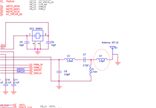

I'd like to inquire about the recommended configuration for RF conducted emissions testing for the BTLE radio on the nRF52832. As in the reference circuit provided in the data sheet, our RF signal flow is as follows:
nRF52832 -> matched network -> 50 ohm antenna
Assuming we remove/disconnect the antenna, does Nordic have a recommended part of this chain where a connection should be made for a regulatory conducted emissions measurement? Should the matched network be removed and the connection made directly to the Nordic or should the matched network be left in place with the connection occurring at the output of the network?
Attached is the relevant portion of our schematic.
Any guidance would be greatly appreciated.
