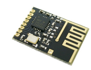

    The IC is marked
    NRF24L01 + M
    1808 A X
    I need to verify what letter "X" is, I have placed it to show you there is a second digita but need to confirm in morning from my office what that second digit is. Doesn't this signify which production plant made the device in 8th week of 2018?
  • This is the module type we use.
    Marking on device is
    NRF   M
    24L01 +
    1808  A H
  • Hi David,
    The component is most likely a fake since we found inconsistencies in the marking. You might want to ask your supplier trough which channel they bought the part. Probably they won't disclose the information.
