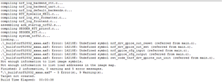

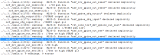

thank you for your reply!!
i modified the code.
but it was occured other warning and error.
i dont know why occured the warning.
please teach me!!
best regards!!
Hi!
Could you tell me where you found those functions you are trying to use?
Joakim
Hi! thank you for your reply!
I made a mistake on the code. In the code of SDK 14 used by me, the functions that were available in SDK 12 could not be used.So i found the function that i can use with the SDK14!!
