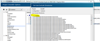

       i am using the Nrf52840 , SDK version 15 with segger embedded studio.
i am developing simple application but i got this issue. i already add the reference in the following location
project-> edit option -> common-> Preprocessor-> user includes dic.
i already used some  custom library which is working fine but not power management  library.
.c file is also included. the error is coming from the linker
here is the output
