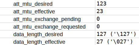

    Yes you're right, I removed the call to data_length_update(conn_handle, p_gatt);
    Here is the GATT information before trying to update data_length:
    No error code is returned by sd_ble_gap_data_length_update.

  • Hi Cyril,
    I apologize for the delayed reply.
    Is the BLE_HCI_STATUS_CODE_INVALID_LMP_PARAMETERS printed in the debug log output from the nRF52832? And is you application peripheral only or a combined central and peripheral?
    From the trace I found the following:
    The nRF52832 is issuing a LL_LENGTH_REQ with the following parameters
    • Max RX Octets:  127
    • Max RX Time:     1128us
    • Max TX Octets:  127
    • Max TX Time:    1128us
    the link master replies with a LL_LENGTH_RSP

    Hence, it appears that the Link master is passing an invalid value in its LL_LENGTH_RSP, i.e. Max RX Time: 256us < 328us.  However, it is wierd that the Link Master replies with these values at all because in the LL_FEATURE_REQ from the Master to the Slave it states that it does not support  LE Data Packet Length Extension.
    We cant do much about the invalid LL_LENGTH_RSP from the peer, but modifying the code so that   LL_LENGTH_REQ is sent not sent by the nRF52832 should be OK, the nRF52832 will still reply to LL_LENGTH_REQ from centrals. The con is that you will not be able to use the increased payload size unless the central initiates the LL_LENGTH_REQ.
