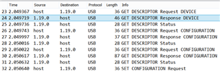

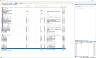

  • This is what I actually see in Wireshark and UsbView:

    Thanks for the code. There's a couple of things that were missing, for instance the direction of the IN data you're sending (should be hal_usb_send_data(0x80 | EP, ...)).
    The reason why your EP callbacks are not running is due to the printf taking too long. I commented it out and now it runs as it should.
    I also count 4 bytes in your mouse descriptor, while in your application it is set to 3 (buttons + X + Y + wheel = 4 bytes).
    Seems to be working fine now:
    Here's the edited .zip: nod_edit_nAN-22_v1.1.zip
    Hopefully I haven't changed that much of your project settings.
    Håkon
