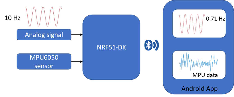

In my project, I aim to send an ADC value (10 bits ADC)  and 6 data (16 bits/each data) from MPU6050 by using nrf51 DK to Android app ( modified from https://github.com/NordicPlayground/Android-nRF-UART). I created two timers for ADC channel and MPU6050 to aim for getting sampling rate of 500 samples/second. Since the buffer of the NUS just has only 8 bits,  I partitioned the value of ADC and 6 data of MPU6050 into values with 8 bits long, which ended up having 2 bytes for an ADC value and 12 bytes for 6 data of MPU. It means that I need to send to Android app total 14 bytes for each time. In Android app, I did a simple technique to combine the data partitioned into real data.
The data of MPU collected on Android app seem correct as I tried to send 6 constant number before getting real data from MPU function; however, there are something wrong in ADC value with sampling rate. I tried to send a sinusoidal wave with the frequency of 10Hz as an analog input, but after receiving data on App, I just got a signal with only 0.71Hz. Without sending 6 data of MPU6050, I can receive sine signal with the same frequency.
Is that because of sending too long data (14 bytes) caused the mismatch of frequency between analog signal and signal after digitalizing?

    I'm not sure I understand what you mean by the following statement:
    Could you please provide some more explanation, with numbers and diagrams?
    Note that nRF51 series do not have DMA features from ADC and SPI/TWI peripherals, like nRF52 series does. The sample rate will be limited by the CPUs availability to handle events. If you have high BLE/radio activity, or frequently read/write TWI/SPI, the ADC will have a lower maximum sample rate.
    Jørgen
  • Thanks for your reply!
    I attached a diagram for my project.
    I aim to send ADC data and MPU data simultaneously by using Nrf51 and receive the data on Android app. To check whether I can digitize the analog signal correctly or not , I tested with a sinusoidal wave hooked up in analog input of Nrf51-Dk. After receiving the data on App, I used FFT to check the frequency and it ended up having wrong frequency as shown in the diagram. I think sending ADC value along with MPU data at once caused this issue. As I mentioned in the main post, I send a package with 14 bytes including 2 bytes for ADC and 12 bytes for MPU data each time. In my point of view, this seemed to create delay, ending up issue.
