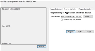

    I am using nRF51-DK board as external programmer  to program Minewtech Minibeacon having nRF51822 chipset (QFABC1, 128KB flash and 16KB RAM).
Tools:
SDK: nRF51_SDK_10.0.0_dc26b5e
ARM tools: 7 2017-q4-major
I have used very simple code (modified blinky code from examples): just on and off led periodically
############################# main.c ############

I have also changed pca10028.h to reflect I/O pin on my Minibeacon

I have also modified blinky_gcc_nrf51.ld to reflect nRF51822 chipset QFABC1 with 128KB flash and 16KB RAM

nRFgo Studio correctly detected my Minibeacon and also successfully programed Minibeacon.
However the code is not working on Minewtech MiniBeacon.
The same code work correctly on nrf51-DK with nRF51422 chipset
