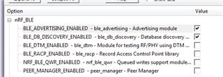

#define CENTRAL_LINK_COUNT 1 /**< Number of central links used by the application. When changing this number remember to adjust the RAM settings*/ #define PERIPHERAL_LINK_COUNT 1 /**< Number of peripheral links used by the application. When changing this number remember to adjust the RAM settings*/ #if (NRF_SD_BLE_API_VERSION == 3) #define NRF_BLE_MAX_MTU_SIZE GATT_MTU_SIZE_DEFAULT /**< MTU size used in the softdevice enabling and to reply to a BLE_GATTS_EVT_EXCHANGE_MTU_REQUEST event. */ #endif #define UART_TX_BUF_SIZE 256 /**< UART TX buffer size. */ #define UART_RX_BUF_SIZE 256 /**< UART RX buffer size. */ #define NUS_SERVICE_UUID_TYPE BLE_UUID_TYPE_VENDOR_BEGIN /**< UUID type for the Nordic UART Service (vendor specific). */ #define APP_TIMER_PRESCALER 0 /**< Value of the RTC1 PRESCALER register. */ #define APP_TIMER_OP_QUEUE_SIZE 3 /**< Size of timer operation queues. */ #define SCAN_INTERVAL 0x00A0//0x50//0x0050//0x00A0 /**< Determines scan interval in units of 0.625 millisecond. */ #define SCAN_WINDOW 0x0050 /**< Determines scan window in units of 0.625 millisecond. */ #define SCAN_ACTIVE 1 /**< If 1, performe active scanning (scan requests). */ #define SCAN_SELECTIVE 0 /**< If 1, ignore unknown devices (non whitelisted). */ #define SCAN_TIMEOUT 0x0000 /**< Timout when scanning. 0x0000 disables timeout. */ #define MIN_CONNECTION_INTERVAL MSEC_TO_UNITS(20, UNIT_1_25_MS) /**< Determines minimum connection interval in millisecond. */ #define MAX_CONNECTION_INTERVAL MSEC_TO_UNITS(75, UNIT_1_25_MS) /**< Determines maximum connection interval in millisecond. */ #define SLAVE_LATENCY 0 /**< Determines slave latency in counts of connection events. */ #define SUPERVISION_TIMEOUT MSEC_TO_UNITS(4000, UNIT_10_MS) /**< Determines supervision time-out in units of 10 millisecond. */ #define UUID16_SIZE 2 /**< Size of 16 bit UUID */ #define UUID32_SIZE 4 /**< Size of 32 bit UUID */ #define UUID128_SIZE 16 /**< Size of 128 bit UUID */ #define NON_CONNECTABLE_ADV_INTERVAL MSEC_TO_UNITS(100, UNIT_0_625_MS) /**< The advertising interval for non-connectable advertisement (100 ms). This value can vary between 100ms to 10.24s). */ #define APP_BEACON_INFO_LENGTH 0x17 /**< Total length of information advertised by the Beacon. */ #define APP_ADV_DATA_LENGTH 0x15 /**< Length of manufacturer specific data in the advertisement. */ #define APP_DEVICE_TYPE 0x02 /**< 0x02 refers to Beacon. */ #define APP_MEASURED_RSSI 0xC3 /**< The Beacon's measured RSSI at 1 meter distance in dBm. */ #define APP_COMPANY_IDENTIFIER 0x004C /**< Company identifier for Nordic Semiconductor ASA. as per www.bluetooth.org. */ #define APP_MAJOR_VALUE 0x00, 0x0F /**< Major value used to identify Beacons. */ #define APP_MINOR_VALUE 0x00, 0x0F /**< Minor value used to identify Beacons. */ #define APP_BEACON_UUID 0xFF, 0xFF, 0xFF, 0xFF, \ 0xFF, 0xFF, 0xFF, 0xFF, \ 0xFF, 0xFF, 0xFF, 0xFF, \ 0xFF, 0xFF, 0xFF, 0xFF /**< Proprietary UUID for Beacon. */ static ble_gap_adv_params_t m_adv_params; /**< Parameters to be passed to the stack when starting advertising. */ static uint8_t m_beacon_info[APP_BEACON_INFO_LENGTH] = /**< Information advertised by the Beacon. */ { APP_DEVICE_TYPE, // Manufacturer specific information. Specifies the device type in this // implementation. APP_ADV_DATA_LENGTH, // Manufacturer specific information. Specifies the length of the // manufacturer specific data in this implementation. APP_BEACON_UUID, // 128 bit UUID value. APP_MAJOR_VALUE, // Major arbitrary value that can be used to distinguish between Beacons. APP_MINOR_VALUE, // Minor arbitrary value that can be used to distinguish between Beacons. APP_MEASURED_RSSI // Manufacturer specific information. The Beacon's measured TX power in // this implementation. }; static void advertising_init(void) { uint32_t err_code; ble_advdata_t advdata; uint8_t flags = BLE_GAP_ADV_FLAG_BR_EDR_NOT_SUPPORTED; ble_advdata_manuf_data_t manuf_specific_data; manuf_specific_data.company_identifier = APP_COMPANY_IDENTIFIER; #if defined(USE_UICR_FOR_MAJ_MIN_VALUES) // If USE_UICR_FOR_MAJ_MIN_VALUES is defined, the major and minor values will be read from the // UICR instead of using the default values. The major and minor values obtained from the UICR // are encoded into advertising data in big endian order (MSB First). // To set the UICR used by this example to a desired value, write to the address 0x10001080 // using the nrfjprog tool. The command to be used is as follows. // nrfjprog --snr <Segger-chip-Serial-Number> --memwr 0x10001080 --val <your major/minor value> // For example, for a major value and minor value of 0xabcd and 0x0102 respectively, the // the following command should be used. // nrfjprog --snr <Segger-chip-Serial-Number> --memwr 0x10001080 --val 0xabcd0102 uint16_t major_value = ((*(uint32_t *)UICR_ADDRESS) & 0xFFFF0000) >> 16; uint16_t minor_value = ((*(uint32_t *)UICR_ADDRESS) & 0x0000FFFF); uint8_t index = MAJ_VAL_OFFSET_IN_BEACON_INFO; m_beacon_info[index++] = MSB_16(major_value); m_beacon_info[index++] = LSB_16(major_value); m_beacon_info[index++] = MSB_16(minor_value); m_beacon_info[index++] = LSB_16(minor_value); #endif manuf_specific_data.data.p_data = (uint8_t *) m_beacon_info; manuf_specific_data.data.size = APP_BEACON_INFO_LENGTH; // Build and set advertising data. memset(&advdata, 0, sizeof(advdata)); advdata.name_type = BLE_ADVDATA_NO_NAME; advdata.flags = flags; advdata.p_manuf_specific_data = &manuf_specific_data; err_code = ble_advdata_set(&advdata, NULL); APP_ERROR_CHECK(err_code); // Initialize advertising parameters (used when starting advertising). memset(&m_adv_params, 0, sizeof(m_adv_params)); m_adv_params.type = BLE_GAP_ADV_TYPE_ADV_NONCONN_IND; m_adv_params.p_peer_addr = NULL; // Undirected advertisement. m_adv_params.fp = BLE_GAP_ADV_FP_ANY; m_adv_params.interval = NON_CONNECTABLE_ADV_INTERVAL; m_adv_params.timeout = 0; } static void ble_stack_init(void) { uint32_t err_code; nrf_clock_lf_cfg_t clock_lf_cfg = NRF_CLOCK_LFCLKSRC; // Initialize the SoftDevice handler module. SOFTDEVICE_HANDLER_INIT(&clock_lf_cfg, NULL); ble_enable_params_t ble_enable_params; err_code = softdevice_enable_get_default_config(CENTRAL_LINK_COUNT, PERIPHERAL_LINK_COUNT, &ble_enable_params); APP_ERROR_CHECK(err_code); //Check the ram settings against the used number of links CHECK_RAM_START_ADDR(CENTRAL_LINK_COUNT,PERIPHERAL_LINK_COUNT); // Enable BLE stack. #if (NRF_SD_BLE_API_VERSION == 3) ble_enable_params.gatt_enable_params.att_mtu = NRF_BLE_MAX_MTU_SIZE; #endif err_code = softdevice_enable(&ble_enable_params); APP_ERROR_CHECK(err_code); // Register with the SoftDevice handler module for BLE events. err_code = softdevice_ble_evt_handler_set(ble_evt_dispatch); APP_ERROR_CHECK(err_code); } static void db_discovery_init(void) { uint32_t err_code = ble_db_discovery_init(db_disc_handler); APP_ERROR_CHECK(err_code); } int main(void) { //lfclk_request(); APP_TIMER_INIT(APP_TIMER_PRESCALER, APP_TIMER_OP_QUEUE_SIZE, NULL); uart_init(); nrf_gpio_cfg_output(14); nrf_gpio_cfg_output(15); nrf_gpio_cfg_output(17); db_discovery_init(); ble_stack_init(); nus_c_init(); advertising_init(); printf("System started\r\n"); sd_ble_gap_adv_start(&m_adv_params); scan_start(); for (;;) { power_manage(); } }

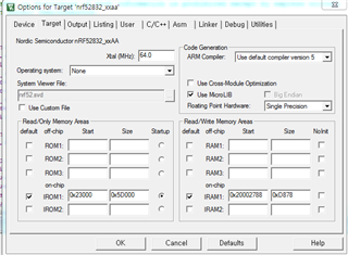

And, I modified ram size.
