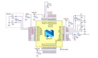

I am working on the iBeacon project.
I want to get the distance to 50m.
Now it detects 5-10 meters.
Soldermask on antenna
Project inspired:
Thanks.

You should start first by checking the range using a basic ble ranging app on Android. The android device will not care that it broadcasts as iBeacon.
On iOS, Apple does some strange things in their core location framework that severly limits the useful range of iBeacons. Its just an iOS issue as the same beacon will perform fine under core bluetooth.
If under droid or core bluetooth you are still not seeing the range you expected than as awneil suggested look into improving your link budget.
but a basic 52832 DK can easily do 50 meters line of sight. If this is a custom board then you likely did not addess the RF matching correctly.

Also I think problem source of C3 (0,8pF) and L1(3,9nH) on pcb.
I need to adjust them according to the antenna impedance.
Is It True?
You can not do much wrong on the firmware other than setting the tx power incorrectly. Just look in the api reference manual for the correct api command to set the tx power. Max for 52832 is 4dBm.
Assuming you are broadcasting at full power then either the antenna is poorly designed or incorrectly matched to the nRF.
Normally the cap and inductor on the nRF just match it to 50ohm. There should be a separate matching network for the antenna.
Matching requires a VNA and someone who knows how to use it. But, if you wish to post your layour, I can comment on obvious errors.

My antenna shows a capacitive effect because the sample is long from the pcb and is 1.6mm between the ground plate.
To correct this, I changed the output filter to 1.2pf to 0.5pf.
Now it is 100m +.
I am glad you resolved the issue.
A mismatched output stage is a pretty common problem.
