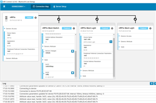

how i can see the state of MESH TOPOLOGY easilly.
I Have seen the tool at the meeting of the asia .
I believe you are referring to the Thread Topology Monitor, right?
yes it is. so do the mesh have topology monitor ?
If you are referring to Bluetooth Mesh, then no. The thread topology monitor is for the thread mesh. Both Bluetooth Mesh & thread are forms of mesh. Bluetooth Mesh uses managed flooded mesh, where messages are relayed from the sending node via a relay node to the destination node. Thread uses routed mesh, which means that a message does not need to get relayed to every device. Potentially, one device can communicate directly to another device without having to relay the message to multiple other nodes.
