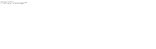

Hellou, I am developing apllication , which is modification of light switch - client model.
I have problem by writing data to internal flash. When I write data to internal flash before function mesh_core_setup(), everything work fine. But when i need data in after inincialization mesh network i receive MESH_ASSERT error. By writing to internal flash, i disable mesh network, but MESH ALLERT is received.

Function set_flash_struct() set address range for operation with flash , and  flash_write_sd() write data to flash. Function are work good before inicialization mesh network, but after inicialization mesh network its not work properly. Mesh is disable by operation with flash storage.  This is also can see on attached picture, see attached file .
