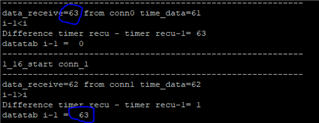

Hello, so I have a central and two peripheral cards that each send their counters to the central.
What I want to do is compare each of the two counters.
But there's a problem every other time the n-1 data is corrupted.
on this image the good coportement
on this image the bad coportement

datatab[i] = data_1_16[p_cid_c_evt->conn_handle].data_receive; // put data on the table
datatab[i-1]= data_1_16[p_cid_c_evt->conn_handle-1].data_receive;
if(datatab[i-1]>datatab[i]){
dif2 = datatab[i-1]-datatab[i]; //compare of two values
NRF_LOG_INFO("i-1>i");
else{
dif2 = datatab[i]-datatab[i-1]; //compare of two values
NRF_LOG_INFO("i-1<i");
NRF_LOG_INFO("Difference timer recu - timer recu-1= %d" ,dif2);
NRF_LOG_INFO("datatab i-1 = %d" ,datatab[i-1]);
NRF_LOG_INFO("-----------------------------------------------------------" );

In green the code concerned.
