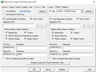

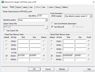

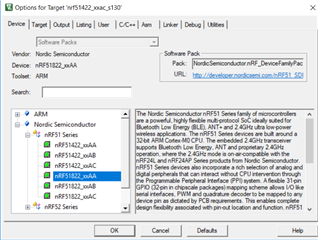

    I was using the Keil, so I will show you my settings, maybe you can see the mistake directly..
    Due to the cheap china hardware, I cannot find a good Documentation, but I guess the xtal on the board is 13,56MHz. With this setting it was not working either.
    This ist SDK10 now, with S130 v1.0.0
    Thank you for the previous help!

  • Did you accommodate for the RAM size being smaller on your device? Your current device has 16k of RAM while examples assume it is the 32k RAM variant of the nRF51822 (QFAC)
  • Yes I left the Flash the same and for RAM I changed the Lenght to 0x4000.
  • The RAM length should be 0x1800, as the softdevice uses 0x2800 (0x4000 - 0x2800 = 0x1800). I suspect you're running out of RAM, which will cause a HardFault in the CPU.
