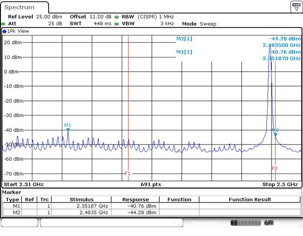

We're designing a BLE module, which is fairly straightforward. The design contains a nRF52832 + SKYWORKS SKY66403-11 FEM. We set the nRF52832 to transmit at -4 dBm and the SKY66403-11 is configured to have 22 dB gain.
When we test the FCC, we failed the unwanted emission. We have a peak located at the 128 MHz below center frequency.
Does anyone have related experience or any suggestions?
