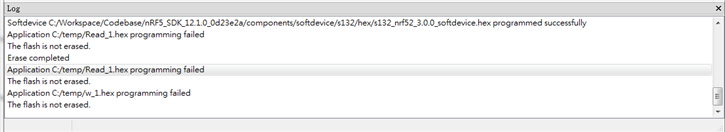

Using nRFgp tool read the image back from device and save to hex file. I erase the flash with another device and try to programme the hex file, nRFgo shows
Application c:/temp/Read_1.hex programming failed
The flash is not erased
Any idea?
That seems to be your problem.
So you need to be looking at why the flash erase is not working ...

Hi! I have the same issue and deleting the line it works.
However I compare the image with the hex file result from build and they have more different lines. Does your device work properly after you loaded the image?
