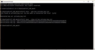

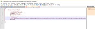

1-2) Generate the keys with the command "nrfutil keys --gen-key private_key.txt", see the keys and change the bootloader_config as you can see in the following images

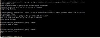

4) Generate the hex page. Using the command "python device_page_generator.py -d nrf52832_xxAA -sd "s132_6.0.0"" (version 6.0.0 as well)

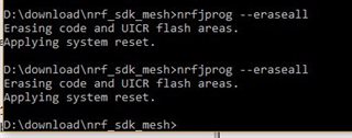

5) Erase all chip, in this case i've 2 developement board
6) Flash the softdevice on all device, i'm using this command "nrfjprog --program bin/softdevice/s132_nrf52_6.0.0_softdevice.hex --chiperase" but i've tryed as well with "nrfjprog --program bin/softdevice/s132_nrf52_6.0.0_softdevice.hex" and the result is the same.
7)Flash the bootloader, here i've the 1st doubt, i'm using segger so i need to choose the gccarmemb right? Anyways i'm actually using it and the command is "nrfjprog --program bin/bootloader/gccarmemb/mesh_bootloader_serial_gccarmemb_nrf52832_xxAA.hex"
8)Flash the application, in this case i'm using segger so i'm just doing the "Download dfu_nrf52..." without any error given. The application that i'm using is the only one on the example dfu folder.
9) Flash the page. Even there i get no error.

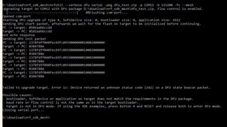

Now i should be able to do the dfu but when i try i get the following error (i'm using the command "nrfutil --verbose dfu serial -pkg dfu_test.zip -p <COM port> -b 115200 -fc --mesh")
I get the same error with both of the com ports, i really don't understand what i'm doing wrong. If someone can help will be much appreciated.

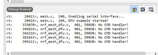

    i've just tried to do the debug with Segger then run the nrfjprog to do the update and the error that i get from segger is the following
    I don't know if that can help to find the problem.

    3: remove "REM" on the first line the first time you run the script to generate the key. Then add REM again, to prevent generating a new key every time.
    4: Copy the key shown in CMD into your <MESH-SDK>\tools\dfu\bootloader_config_default.json file, like described in the guide.

    Anyways i follwed your instruction for the bootloader verification. If i do all the procedure as described this is what i get
    The error still persist and is the same
