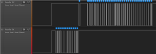

Good afternoon,
I am able to write data using polling mode with the macro NRF_SERIAL_CONFIG_DEF(serial_config, NRF_SERIAL_MODE_POLLING,  NULL, NULL, NULL, NULL). I am using the peripheral example serial program in the nrf5 SDK v15.0.0. I checked the UART lines with the Logic Analyzer and it shows bytes sending to and receiving from the machine. However I am not able to read the incoming data stream with the nrf_serial_read function. The function will block and never return.
The functionality I am trying to achieve is very trivial and does not need any complex queues and interrupt handlers. I just have to read and store data from the UART. An example or code snippet describing the nuances of the nrf_serial_read function would be very helpful.
Thank you in advance.
Sabine

    Are you inputting any data to the RX line of the UART? And if you are, have you checket the pin with a logic analyzer to see that it is actually input on the pin?
    Since you have set the timeout_ms parameter of nrf_serial_read to NRF_SERIAL_MAX_TIMEOUT, the call will block until the requested amount of bytes have been received.
    Jørgen
  • Yes, there is input on the pin. The snapshot of the logic analyzer shows the RX on line 1 and TX on line 2. On the TX line I am sending the following command (0x09, 0x73, 0x00, 0x00, 0x00, 0x02, 0x01, 0x10, 0x00, 0x02). On the RX line the Machine Control responds with an ACK (0x06) and returns with its machine control initialization packet  (0x02,0x1F,0x74,0x70,0x09,0x04,0x00,0x00,0x04,0x00,0x01,0x04,0x00,0x00,0x54,0x2F,0x63,0x00,0x21,0x58,0x60,0x00,0x00,0x00,0x00,0x00,0x00,0x00,0x00,0x00,0x00,0x00,0x00)  and a block check character (0x14).
  • Have you made sure you have configured the serial interface with the same pin number that the RX signal is applied to?
    Could you try debugging the application, to see exactly what line it is stuck on? Also please try stepping the code to see if it enters the UART driver and get some events in this.
  • I got it all figured out. Thank you.
