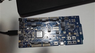

Please add nRF52840_DK to boards os.mbed.com/.../
mbed is not driven by Nordic, so you have to ask mbed to add the nRF52840_DK to https://os.mbed.com/platforms/
As for the first question:
Which usb port on the DK do you use?
You should use the one on the left in the upper picture in this link.
The switches should be in position VDD and DEFAULT.
So if you want to program the nRF52840 DK, you should use the USB connector with the red circle around, SW9 - nRF power source: VDD and SW6: DEFAULT.
I am not familiar with mbed, but if the nRF52840 is not yet supported there, you can check out our SDK, which contains a lot of examples you can play around with. Segger Embedded Studio (Segger's IDE platform) is also supported, which is free of charge to use, with no limitations.
Edvin
1.I used introduction link :https://os.mbed.com/docs/v5.9/tutorials/quick-start-online.html
2. I don't have this Studio and not CL tools.I want to use high-level programming language with less code as possible. for this kind users was created Mbed and I wan't to use it. So please make it work/
I am just trying to figure out whether your issue is in the project/compiler or if it is in the upload procedure.
Can you try to power cycle the DK after uploading the .hex file using drag'n'drop?
nRFgo Studio is a quite easy-to-use, and self explaining application.
Edvin
I told it many times that I know it and it work. Examples I tried with SEGGER Embedded Studio worked.
Problem in code that generated by online compiler. Nordic + ARMbed need to solve this problem.
I guess that the nRF52840 platform is not working yet. If you compile the project that you linked with this main.cpp:
#include "mbed.h"
DigitalOut led1(P0_13); //LED1 = 13 on nRF52840 DK
// main() runs in its own thread in the OS
int main() {
while (true) {
led1 = !led1;
wait(0.5);
And use the nRF52DK as platform, it works.
After uploading the binary, you have to power cycle the board(!) not just the reset button.
I know that this is not ideal. But I have no better solution, until a stable version of the nRF52840 platform is released on mbed.
Edvin
If you look at start of discuss I started with nRF52DK as platform and always power cycle the board.
ARMbed found bug in last version of mbed 5.9.2 When I swapped to 5.9.1 led is worked.
