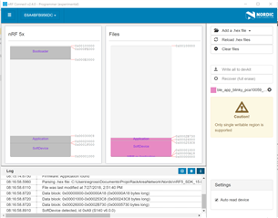

Just got four 52840 USB dongles, with the intent to evaluate the Nordic BT Mesh.  But I've been  unable to get even a simple Blinky example programmed on the dongle.  I've tried both Windows and Mac, I'm sure I'm doing something wrong, any pointers are appreciated.  I found this info the forum, but my errors are somewhat different:
https://devzone.nordicsemi.com/f/nordic-q-a/36844/nrf-connect-programming-pca10059-issue?ReplySortBy=Votes&ReplySortOrder=Descending
When using nRF Connect v2.4.0, I can see the device and connect to it.  But it will not let me write or erase the device, I get a box under the recover button that says "Only single writable region is supported", and both the "Write all to devkit" and "Recover" buttons are disabled.  See attached image

  • I am seeing a similar issue.
    Please see:
    https://devzone.nordicsemi.com/f/nordic-q-a/36381/nrf52840-dongle-write-problem
    Not sure if it's the official response, but one user says:
    "for the time being loading projects to the dongle using a softdevice is not supported by the nRF Connect for Desktop app. "
    UPDATE 1:
    You can program the dongle via SWD if you have a DK. Just power it from the DK so VTG is detected correctly.
    This is correct. The nRF Programmer app for nRF Connect for Desktop does not currently support programming the SoftDevice to the dongle, but this will most likely be supported in the next release. The only option at this point is to use nrfutil, which is part of nRF5x-Command-Line-Tools.

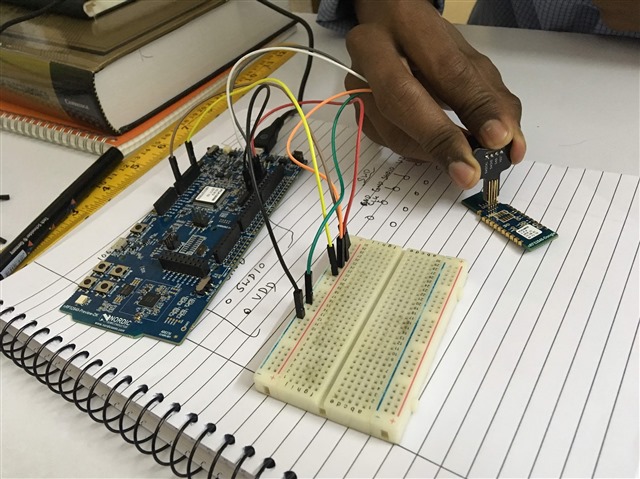

    4) It is possible to flash via "nrf52 DK and tag connect cable" using ses 'build and run feature' menu
    Yes, you can program (and debug) an application on the nRF52840 dongle using the DK as an external debugger.
  • Ok, thanks for answers.
    2) Please see pictures below. I'm using the project ble_app_blinky_pca10059_s140 included in SDK 15.2.0. As can be seen from the pictures, the compiled hex does not contain neither bootloader, neither softdevice, only application. Start addresses seems to correctly overlap with the app on the dongle, not over memory blocks. Clicking "Write" on nrfconnect app, asks for softdevice and then selecting s140, it fails.

  • I assume you have S140 version 6.1.0? There is a limitation in the nRF Connect Programmer app that you have to select SoftDevice version from a drop-down. So if the programmer app is not updated for the current SoftDevice it will not allow you to program the app alone. I have created an internal feature request suggesting that it be possible to select to skip the SoftDevice ID check (by setting ID 0x00). In the meantime the workaround is to simultaneously install the application and SoftDevice (by adding the SoftDevice .hex file in addition to the application .hex file before clicking "Write".
