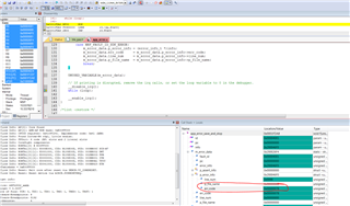

To implement ble_uart peripheral service in central and peripheral relay example !!!!!!!
I am trying to implement UART service which should act as both central and peripheral at a time.
So, I started implementing ble_uart peripheral service into the central and peripheral relay example.
I dumped a ble_uart central example in one board and modified relay example in another board.
both are able to connect but no data transmission is happening between the boards.
I am using nrf52832 boards, SDK  12.3.
