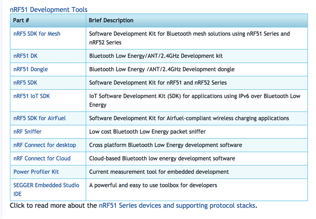

    The documentation for the nRF5 SDK indicates that it works with both the 51 and 52 variants of your products. See: https://www.nordicsemi.com/eng/Products/Bluetooth-low-energy/nRF5-SDK
    The web site also makes it appear the SES is the preferred way to develop for nRF51. See:
    Note the last item in the table: SEGGER Embedded Studio IDE. If SES only works with SDK versions 14 and later, and nRF51 support stopped with 12.3, then this is wrong and misleading.
    When you go to the "Downloads" tab, that page shows two options, 12 and 15. The text describing these options discusses various SoftDevices, but it makes no reference to the actual hardware that is supported by them. This is incredibly confusing to someone who is not deeply versed in Nordic's products. It would make a great deal more sense if the downloads were segmented by hardware, THEN by preferred SoftDevice image.

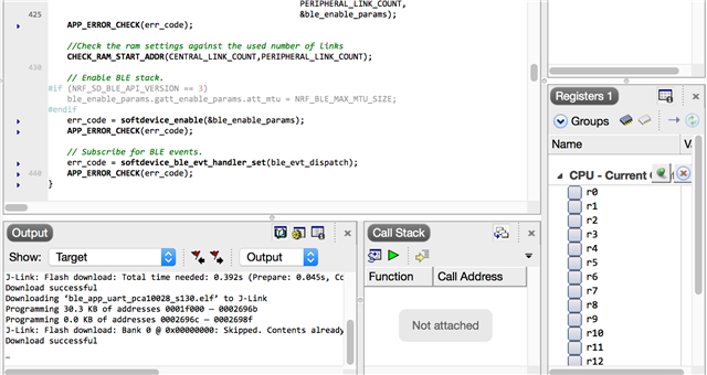

  • After beating my head against GCC and Makefiles for a while, I went back and did some additional searching. I finally ran across this post, which seems to indicate that it is (or was) possible to use SES with 12.3 to build for the nRF51 family.
    I followed the tutorial in that post and have been able to compile the "ble_app_uart" example and flash it and the associated s130 SoftDevice. However, something appears to go wrong during the initialization of the application (or the SoftDevice) as the debugger never attaches. Here's the output from the console:
    Preparing target for download
    Executing script TargetInterface.resetAndStop()
    Reset: Halt core after reset via DEMCR.VC_CORERESET.
    Reset: Reset device via AIRCR.SYSRESETREQ.
    Downloading ?s130_nrf51_2.0.1_softdevice.hex? to J-Link
    Programming 1.9 KB of addresses 00000000 ? 000007bf
    Programming 103.9 KB of addresses 00001000 ? 0001afdf
    J-Link: Flash download: Bank 0 @ 0x00000000: 1 range affected (2048 bytes)
    J-Link: Flash download: Total time needed: 0.392s (Prepare: 0.045s, Compare: 0.281s, Erase: 0.043s, Program: 0.013s, Verify: 0.000s, Restore: 0.007s)
    Download successful
    Downloading ?ble_app_uart_pca10028_s130.elf? to J-Link
    Programming 30.3 KB of addresses 0001f000 ? 0002696b
    Programming 0.0 KB of addresses 0002696c ? 0002698f
    J-Link: Flash download: Bank 0 @ 0x00000000: Skipped. Contents already match
    Download successful
    And here's what I see on the screen:
    Any idea what I may have done wrong? Apparently others have managed to use the (somewhat outdated) recipe to make make (an older version of) SES work with 12.x.

  • Still going. I initially had some problem with the thumb_crt0.o output, presumably generated by the changes to the thumb_crt0.s file. I assume that was due to changes since the tutorial was written and simply removed the changes. Not sure if that's the issue, but the changes are still causing errors:
    1> Linking ble_app_uart_pca10028_s130.elf
    1> Output/ble_app_uart_pca10028_s130 nrf51422_xxac/Obj/thumb_crt0.o: In function `memory_set':
    1> /Applications/SEGGER Embedded Studio for ARM 3.40/source/thumb_crt0.s:172: undefined reference to `__fs_data_load_start__'
    1> /Applications/SEGGER Embedded Studio for ARM 3.40/source/thumb_crt0.s:173: undefined reference to `__fs_data_start__'
    1> /Applications/SEGGER Embedded Studio for ARM 3.40/source/thumb_crt0.s:174: undefined reference to `__fs_data_end__'
    Build failed
    Nordic - please take the time to add full and proper support for SDK 12.3 to SES or at least publish an updated tutorial. This is becoming aggravating.

    Then, make sure to delete the old thumb_crt0.s file in the Internal Files folder in SES & add the new thumb_crt0.s file using -> "Add Existing File...".
    I do not believe the memory usage display in SES will show you where the softdevice will be placed. It should be similar to this:
    This is what I received & the softdevice was still loaded successfully. Unfortunately my device is still not advertising for some reason. As soon as I figure out what the issue is, I will update this comment.
  • Hi Bjørn,
    Apologies for the delayed response on this ticket. I was able to work my way through the Kiel import process and managed to get SES working with the changes to the flash_placement.xml file, the thumb_crt0.s file and the Section Placement Macros values in the Linker configuration. With those changes I have a working environment.
    How difficult would it be for someone (someone at Nordic - hopefully an intern with a good deal of patience) to go through that process for each of the examples, for each of the SoftDevices, for each of the development boards and then publish a v12.3.1 release of the SDK with SES project files?
    I know the nRF51 line isn't the going forward product, but there many modules out there that are built on that legacy line and which are still being incorporated into new products - mine included.
    Please feel free to close this ticket.
    Thanks!
    -S
  • Hi ,
    Great to hear that you got it working! Unfortunately, it is unlikely that we will make updates to an old sdk. I can mention it internally, but I am not sure it will get much traction. What we can do though is update the blog post to work on sdk 12.3 examples.
    I have also mentioned your other two pieces of constructive feedback regarding the small changes to the download tab in nrf sdk 15 & creating an updated getting started guide for nRF51/2 on each of the three development platforms (Windows, Mac, Linux).
    Kind Regards,
    Bjorn
  • Just wanted to let you know that we have updated the nrf5 sdk download tab thanks to you. We really appreciate honest feedback from customers such as yourself.
