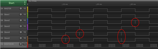

To visualize this, I've also set up a PPI channel which connects TIMER1->EVENTS_COMPARE[2] to a GPIOTE channel which toggles a GPIO whenever this occurs.
The system works fine, but I am noticing that occasionally (1 in 2 to 1 in 6 timer compare events), the GPIOTE triggers twice in very quick succession; usually 120ns apart. A logic analyzer can see this very easily:
Now I've been using numerous nRF51822 rev silicon: QFAAC0, QFAAG0, QFAAFA and CEAAE00 and the problem occurs across all of them. There is a PAN v2.4 which I've read and #26 (manual setup required to enable use of peripherals) and #57 (Concurrent operations on the PPI peripheral will fail). These PANs don't apply to the CEAAE00 part but even with the workarounds the glitching persists.
I'm also using four nRF51422 QFACA1 dev boards which also exhibit the glitch.
What is the cause of this? Can it be mitigated?
