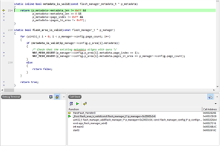

HardFault when add app_flash_manager_add to light switch proxy server
Hi all,
I want save and read flash in example light switch proxy server .
I add code part of provisioner example into proxy server example
This is my code ;

void app_flash_manager_add(void)
    flash_manager_config_t manager_config;
    manager_config.write_complete_cb = NULL;
    manager_config.invalidate_complete_cb = NULL;
    manager_config.remove_complete_cb = NULL;
    manager_config.min_available_space = WORD_SIZE;
    manager_config.p_area = (const flash_manager_page_t *) (((const uint8_t *) dsm_flash_area_get()) - (ACCESS_FLASH_PAGE_COUNT * PAGE_SIZE * 2));
    manager_config.page_count = CUSTOM_DATA_FLASH_PAGE_COUNT;
    uint32_t status = flash_manager_add(&data_flash_manager, &manager_config);
    if (NRF_SUCCESS != status)
        __LOG(LOG_SRC_APP, LOG_LEVEL_ERROR, "Unable to add flash manager for app data\n");
And in main. c , I call app_flash_manager_add() , but it  appear hardFault in static inline bool metadata_is_valid(const flash_manager_metadata_t * p_metadata)
This is call stack :
Pls , help me , thank !!!
