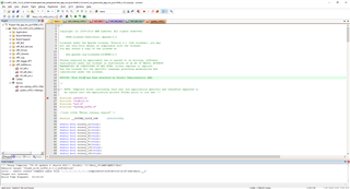

The application nrf52832_xxaa  compiles, and downloads, the Softdevice (which I assume I also need to manually compile), appears to be available in the via the drop-down 'select target' option in keil. I change to this and see a load of errors in the files list.
Attempting to compile this gives the error:
Rebuild target 'flash_s132_nrf52_6.0.0_softdevice'
error - cannot create command input file '..\..\..\..\..\..\components\softdevice\s132\hex\main.__i'
Target not created.
The application wont run to main - I assume this is because the soft-device is not present?
I am using Keil uVision 5.23 together with nRF SDK 15.0.0_a53641a

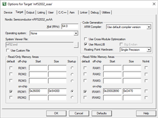

My config is thus:
  • Your mixing SDK11 with the S132 V6 from SDK15, they are not API compatible.

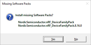

  • So, I removed the keil packs for nordic (by deleting the folder under packs as there is no 'remove group' option in the keil pack installer)., with the intention of the example using only the methods provided by SDK15. As soon as I remove the pack, Keil moans that the pack is not installed, and refuses to build the example:
    Error instantiating RTE components
    Error #544: Required Software Pack 'NordicSemiconductor.nRF_DeviceFamilyPack.8.16.0' is not installed
    Error #543: Device nRF52832_xxAA(Nordic Semiconductor) not found, pack 'NordicSemiconductor.nRF_DeviceFamilyPack.8.16.0' is not installed
    Error #541: 'NordicSemiconductor::Device:Startup:8.16.0' component is missing (previously found in pack 'NordicSemiconductor.nRF_DeviceFamilyPack.8.16.0')
    Target not created.
    Build Time Elapsed: 00:00:01
    It also pops up the following dialog box when I load the example from the SDK:
    Appears that I have no option but to use the Keil-Supplied packs for Nordic if I wish to build the examples??
    I have pointed the Nordic pack installed at the SDK15 via File-->Import From Folder, refreshed and then re-installed the Packs in order to get the example working again --- is this what you meant re 'don't use the keil packs', eg I am not using the SDK15 'as is', but rather importing it as packs into Keil??
