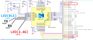

chip:nRF52810
SDK:nRF5_SDK_15.0.0_a53641a
examples:ble_peripheral \ ble_app_uart
external chip (UART Tx) ---> (UART Rx) nRF52810 (BLE) ---> mobile phone

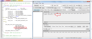

    【1】Board power on ,  UART Debug tool can print 【UART Started】 , but send data , inability to enter uart_event_handle() (callback) , is enable need to open, or other settings?
    【2】UART Debug tool can print the data from the phone ,  if enter uart_event_handle() , this function ble_nus_data_send() is send data to mobile phone ?

    [1] How do you know that it doesn’t enter uart_event_handle(..)? Have you tried to debug, and setting a breakpoint inside the function? Toggling a LED would also work.
    Does the value of “TX Characteristics →Value” inside the nRF Connect app change after sending a message over the terminal (assuming you have enabled notifications by clicking the 3 arrows marked with green in the image below)?
    [2] The terminal (UART Debug tool) should print the data sent from the phone, you can test it out by enter in a message by clicking the arrow up in the nRF Connect app beside RX Characteristic (marked with red in image below).
    “if enter uart_event_handle() , this function ble_nus_data_send() is send data to mobile phone ?”: Yes, you are right. When entering uart_event_handle(), the data received over UART will be sent over BLE to the phone through the ble_nus_data_send() function.

  • Thank you for answer ,
    UART debug tool all the printed messages are APP_UART_TX_EMPTY
    But I want to print a message from the UART debug tool
    In the end I'll send the data to mobile phone

  • Do the pin assignments in uart_init() match your configuration? If you are using for ex one of the nice Fanstel modules you may need to change off the default pins.
