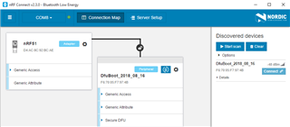

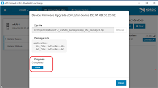

    The Segger JLink version is OK, since both of the EVBs work fine as connectivity boards when I work with the "nRF Connect v2.3.0" running on my PC (see attached figures).
    PCA10040  as connectivity board:
    PCA10028 as connectivity board:
    In both cases I can perform successful secure DFU with many ZIP packages that I have created.

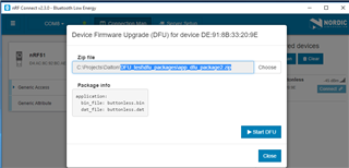

    As usual the same combination of boards and packages worked fine with my PC nRF connect program.
    Here are some screenshots:
