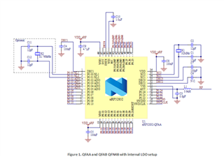

Is there an easy/quick way to check whether the nrf52832 chip is working?
I have connected the components mentioned in the reference schematic from the official website to my nrf52832 chip. Is there any easy method to know whether it is working? I have used the voltage meter and found the crystal and all the capacitors having voltages. Could it be a sign that everything is ready? I am really worried about the connection of the nrf52832 pins when I do the soldering so I want to make sure it is good.
Also, I tried to program my nrf52832 chip via the nrf52 dk SWD after I completed all the cable connection, but the nrf studio indicated that there was no device detected. Do I need to add other components to program it via SWD?
Any suggestion would help me a lot.
