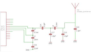

Hello
Im preparing a device that uses nRF51422 for CE and FCC testing. I need to disconnect the antenna and put a connector in it's place for the testing. I have doubts about the exact point of the circuit where i should disconnect the antenna.
Is there a recommended part of this chain where a connection should be made for conducted emissions measurement?
This is the schematic of the antenna connection for our circuit:
