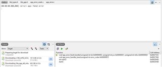

Second, I want to test the long range mode.
So,  I have added primary_phy and secondary_phy. But, When the primary_phy is BLE_GAP_PHY_CODED, It returns error.
However, When the primary_phy was BLE_GAP_PHY_1MBPS, it worked well.
So, should I set the primary_phy to 1MBPS and change it as an event?

  • Yes, I saw. In the attmtu example, changing primary phy to coded phy returned in an errror.
    Is coded phy changeable after it is triggered by an event? I wonder if it is necessary to change step by step event if only the long range mode is used.
  • Please understand that I am not a complete expert in F/W.
    I have changed primary phy to coded phy. And then this situation was discovered.
  • Did you change the primary phy to BLE_GAP_PHY_CODED in the advertising_data_set() function in main.c?
    Could you upload the code snippets where you changed the primary phy to BLE_GAP_PHY_CODED? Also, did you leave the secondary phy at BLE_GAP_PHY_1MBPS or did you changed it to coded phy too?
