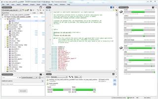

But now I would also like to see in real time the RAM and ROM consumption (in %) of the nrf52840 board with uvsion keil.
But I don't see how to do on IDE
like this but on uVsion keil.
Take a look at the nrf connect for desktop programmer app. There, you can read out the ROM usage & where the softdevice, application and/or bootloader are located in flash. This documentation might be helpful for Keil. Take a look at the bottom of the map file (e.g. nrf52832_xxaa.map in the _build folder), where you can see the different ROM & RAM sizes. Here is an example below:
Total RO Size (Code + RO Data) 22320 ( 21.80kB)
Total RW Size (RW Data + ZI Data) 10648 ( 10.40kB)
Total ROM Size (Code + RO Data + RW Data) 22400 ( 21.88kB)
I am not sure whether you have the graphical RAM & ROM usage in Keil like you do in SES, but you can also see how much ROM & RAM you've allocated in the Target tab under Options for Target in Keil.
