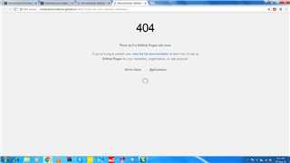

thanks for reply. The above thread mentioned links are not available.
