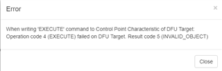

I used nrfutil.exe (v3.5.1 based on python v2.7.13) to create bootloader.zip file from SDK v15 - \dfu\secure_bootloader\pca10040_ble\  sample code.
CMD : nrfutil.exe pkg generate --hw-version 52 --sd-req 0xA8 --bootloader nrf52_bootloader.hex --bootloader-version 0xFF --key-file key.pem nrf52_bootloader.zip
After got nrf52_bootloader.zip and let nRF52-DK jump to DFU mode, I used APP - nRFconnect or nRFtoolbox to update it but it shows fail (Invalid object).
The same command, I just changed bootloader hex file to application file (ex :ble_app_hrs) then create application.zip, it can update application.zip by APP - nRFconnect & nRFToolbox.
Could you help to check this issue?
