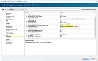

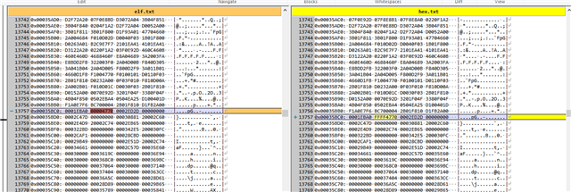

    I encountered the same problem here. That is, checksum of app image did not match with the one stored in the generated bl settings page and therefore became stuck in DFU mode. Further debugging revealed that the there was a slight difference if I uploaded the .hex file instead of the .elf file in the build directory:
    Not sure if this is expected behavior or if it is a bug in binutils (tested with SES v.3.50). In any case, I worked around this be changing the debugger settings in SES to upload the .hex file instead. Screenshots of my configuration:
    (Post build command :  nrfutil settings generate --family NRF52840 --application $(OutDir)/$(ProjectName).hex --application-version 1 --bootloader-version 1 --bl-settings-version 1 $(OutDir)/settings.hex)
