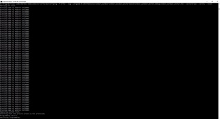

I'm able to erase it with "erase all" command or with nrfgo Studio, but when trying to download the firmware with loadbin I get the same error as in Segger IDE
loadbin firmware.bin,0x00000000
Halting CPU for downloading file.
Downloading file [frimware.bin]...
J-Link: Flash download: Restarting flash programming due to program error (possibly skipped erasure of half-way erased sector).
J-Link: Flash download: Skip optimizations disabled for second try.
Error while programming flash: Programming failed.
and it seems that the jlink is having a hard time switching to another page of the flash memory cause I can see that starting from address 0x00001000 the flash is still empty!
Starting to write the bin file from page 1 ( loadbin firmware.bin,0x00001000) produce the same behavior : page 2 ( 0x00002000 ) is empty
Writing bytes directly to the flash seems to work correctly :
J-Link>w4 1000,DEADBEEF
Writing DEADBEEF -> 00001000
J-Link>mem 1000,4
00001000 = EF BE AD DE

  • Thank you Bjorn,
    I used the P20 ( VGT,SWD IO, SWD CLK, RESET and GND DETECT).
    I tried the commands you mentionned but got the same results !
    I was able to download the firmware on some boards (2 of 6) so I asked the production team to check them but they couldn't find anything wrong with the soldering or the components. It's confusing how we can erase, write to a single page of the flash and not able to write the hole firmware ! Any idea where this behavior could be coming from ?
    Thx,
    Chaabane
  • Which version of nrfjprog did you use? Which version of JLink do you have installed?
    If you have 6 identical boards, but you're only able to flash two of them, then I could sound like a hardware issue. Could you capture a logic trace of the SWDIO and SWDCLK pins for  one of the "good" devices that you're able to flash and one of the devices you are not able to flash and then compare the traces?
  • nrfjprog version 9.7.1 and Jlink 6.34b
    I compared both SWD traces. the clock is stable at 880-1000 KHz.
    In the case of the bugged board  values read from the debug port and the access port (after read request ) are not always the same as the returned values in the working board. the trace on CLK and IO looks normal for the write cycles before these reads. Below is the records for SWD trace for both boards if it might help

  • Are you using a Saleae to capture the traces? If so, could you provide the traces as .logicdata files and not .csv? It makes it a bit easier to analyze.
    Could you also try the nrfjprog commands again, but this time append the --log option. The nrfjprog log output will then be placed in a log.log file in the directory where you called nrfjprog from. Please attach the logs to this case.
  • Please, Find attached the requested logs
    working board.logicdata
    Notworking board.logicdata
    nrfjprog --log --family nrf52 --eraseall

  • Attached is the logs with the newer version and the screenshot of the console.
    With this version It worked with the blinky example hex file but not with my project hex file.
    1067.log.log
    Thank  you
  • Great! Is the screenshot showing all the nrfjprog terminal output, i.e. is verifying programming the last line that is printed? To me it looks like the code was written to the device? Have you tried reading back the flash content and comparing it to the original hex file?
