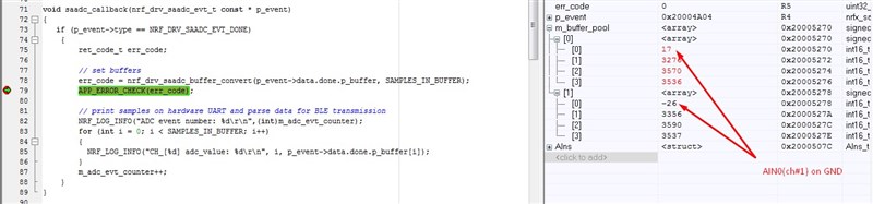

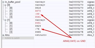

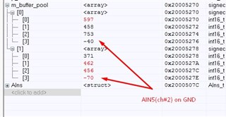

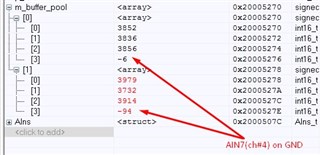

Problem:
Channel's position numbers doest match their positions in output. And sometimes hopping in arrays...
For example, I'm shorting AIN0 (channel #1) to GND and thats what I see under debug:
AIN5 (channel #2):
AIN4 (channel #3):
AIN7 (channel #4):

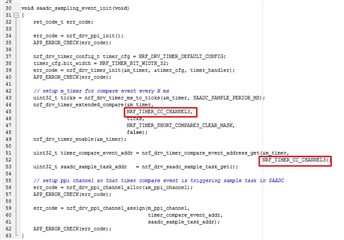

And one more things I would like to ask:
Since TIMER0 is used by softdevice, I'm using TIMER3 for SAADC. Am I correct that in saadc_sampling_event_init() I shoud compare events/adresses for TIMER3?

    I setup your configuration in the peripheral/saadc example, and tried to replicate the issue, but unfortunately; I was not able to do so.
    I connected AIN0 and AIN4 to VDD, AIN5 and AIN7 to GND, and the output is always consistent (+/- a bit of jitter):
    <info> app: ADC event number: 118
    <info> app: channel: 0 value: 854
    <info> app: channel: 5 value: -2
    <info> app: channel: 4 value: 840
    <info> app: channel: 7 value: -2
    Do you see this issue often? Or is it something that occurs only in corner cases?
    Håkon
